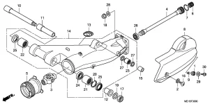

Also bad universal joint may cause sometimes vibrations (No. 3 on image).
It related to the back end, i feel it in seat. Also mirrors shaking. Wheel bearing is like new. I was thinking about universal joint too, i want inspect it today :)
If you already get there, maybe it would be a thing to check also swingarm related bearings situation?
