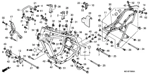

and disassembled the parts so I can see what's wrong. I have a question about the subframe. I took pictures of it and there is a slight bend on both sides. I think this is normal and no damage. Do you know anything about that?
The engine is from 2008 by the way. And those links are very nice - thank you
the third foto is the side on which the motor has fallen
It's a bit hard to say is the subframe bent or not by your photos. If it fits and is visually checking ok, then it probably is ok. You can look also for a cracks in paint on frame tubes, this will show out the possibly bent places.
The image from parts list may give some clue, there are some factory made bendings to be seen.
Yes I have the drawing and also found that there is a slight bend in it. There is nothing visible on the paint and the welds, so I am assuming the right one. Subframe is OK
