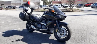

Congratulations on being an awesome owner of DN-01. I set the frame up quite a while ago. I will post it where I purchased it if I find it. Enjoy the ride and be safe! Best,DN-01 1.webp

Re-starting an old thread.
I really want to see a photo of the mounting bracket and process at the top of the side case frame.
I think that I can produce a bracket that can be welded onto other givi side case holders reasonably simply. I know famous last words.
Note that the square pannier brackets in the above pic are shown mounted upside down. The top of the panniers are roughly level with the seat when fitted. For the Give V35 panniers.
You could perhaps try these correct brackets for the V35 and adapt them to mount to the existing topbox rail, well. that's what I'd do. Hey - that gives me an idea........ 🤔
[/URL]
[/URL]
Yea I noted they were upside down. It looks like you are thinking a bit like me. I have bought a set of frames for another bike that lets me mount smaller cases and will make the mounting brackets.
